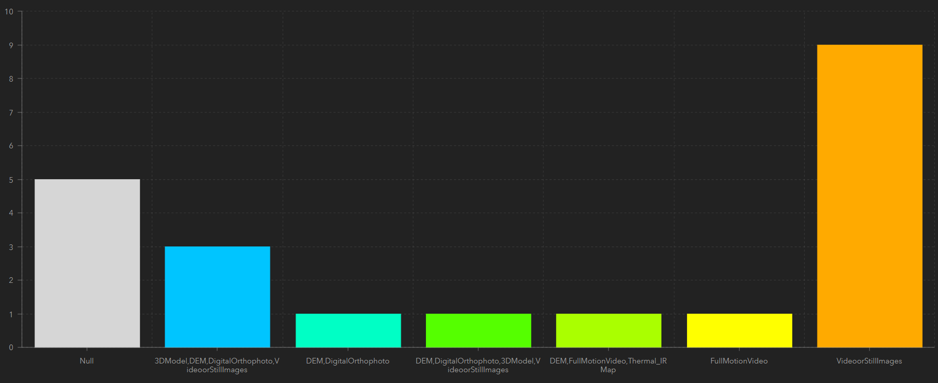

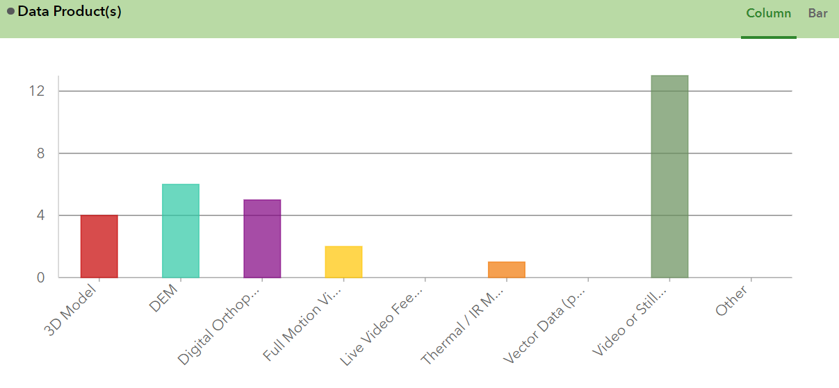

I'm looking for any suggestions or solutions to using a Survey123 select_multiple response within Operations Dashboard.  This question type outputs as a comma delimited field which makes it pretty much unusable in Ops Dashboard.
I went through the steps of pulling out the unique answers into hidden fields as yes/no... through the calculation column:  if(selected(${name},'somevalue'), 'Yes', 'No')  ...but still can't find a good solution to displaying/summarizing this info in any of the Dashboard elements.
What I would like to be able to do to count the number of times a value (not a response) has been selected for each question and also graph those with the other.  This works well in the survey123.arcgis.com website, but Ops Dashboard is completely different...

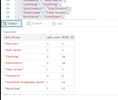

Bec
I finally figured out what was causing the issue in my data expression.  I had my decode dictionary values backwards.  I reversed those and now the code works as expected!  I included a picture of my output when I tested the data expression.
