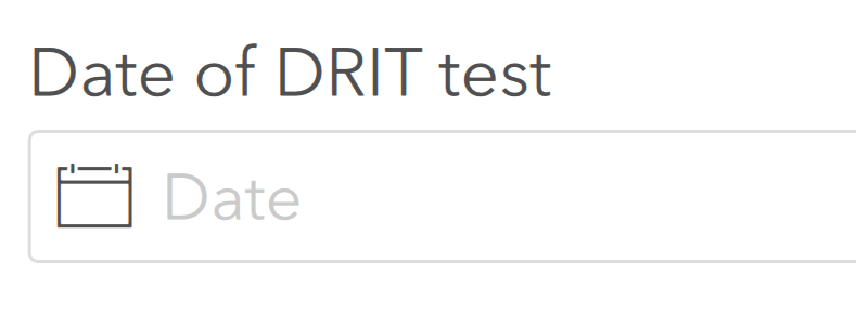

The form has a question, "date_drit_test" that the user can leave blank (if no test occurred) or fill out (if a test occurred):

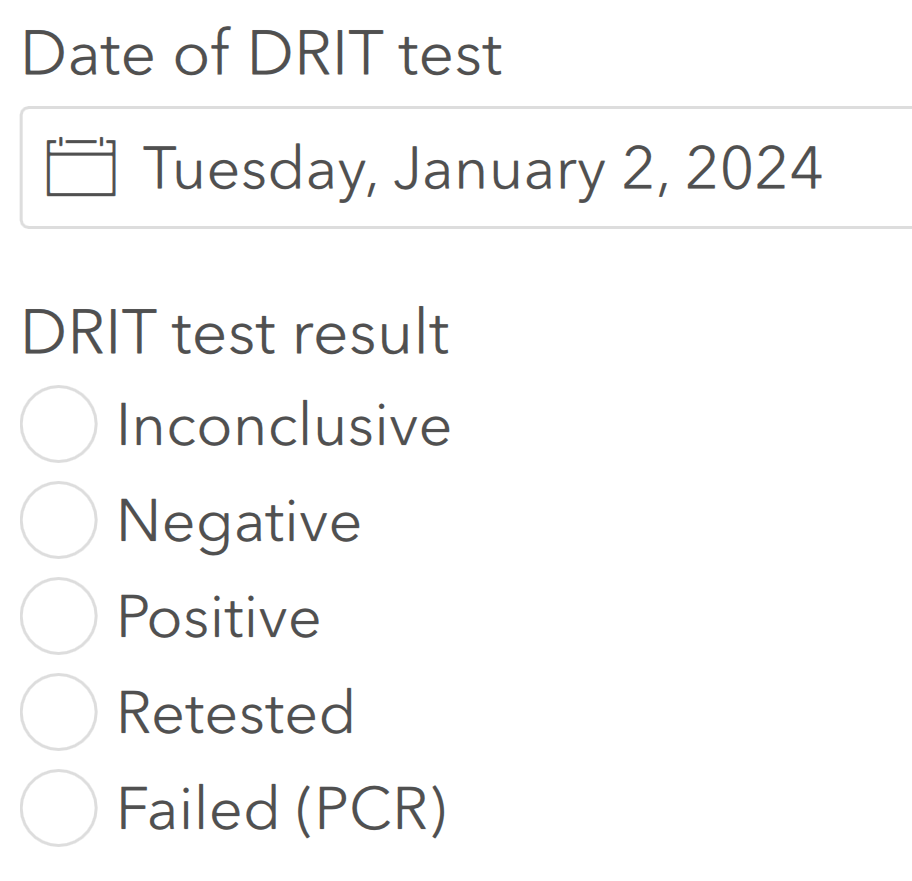

If the user selects a date, then another question, 'drit_test_result' should appear to indicate test results (which was hidden if no date was selected):

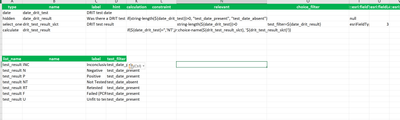

Relevant worksheets & fields:
survey worksheet
typenamelabelcalculationchoice_filterrelevant
datedate_drit_testDate of DRIT test
hiddendate_drit_resultWas there a DRIT test date?if(string-length(${date_drit_test})>0, "test_date_present", "test_date_absent")
select_one test_resultdrit_test_resultDRIT test result test_filter=${date_drit_result}string-length(${date_drit_test})>0
choices worksheet
list_namenamelabeltest_filter
test_resultINCInconclusivetest_date_present
test_resultNNegativetest_date_present
test_resultPPositivetest_date_present
test_resultNTNot Testedtest_date_absent
test_resultRTRetestedtest_date_present
test_resultFFailed (PCR)test_date_present

Simple solution is to rename drit_test_result to something list drit_test_result_slct then add a calculate:
EDIT: Updated calculate. I forgot to include the jr:choice-name() component to save the label rather than the name. Basically, just need to choose whether you want to save the name or label from drit_test_result_slct.

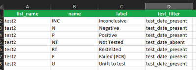

Choices tab:

EricaNova
I replaced the single quotation marks with "" and it works better... but now I'm getting labels in one field and code in the other:
