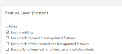

With the recent updates to Survey123, you need a globalID. In your layer's settings, turn on "Enable Sync" to easily add the field. You can turn the setting back off after, if that's a particular concern.

I have the globalid on, but it still was not able to work.
