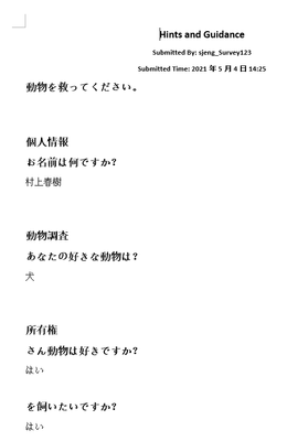

Could you explain more about your isssue? The report content will print the langauge based on the ArcGIS acccount profile language. For example, my AGOL account language is set to Japanese and my survey does have a Japanese version. When I log on to survey website and print the report, the report will be printed as Japanese. Is this what you are asking?

I was not able to rerpoduce the issue even with pdf file and I also used 3.12 Connect to publish the survey.
Is it possible you can share yout XLSForm with me to test it in house?
If you prefer not to share publicly, you can email it to me (sjeng@esri.com).
