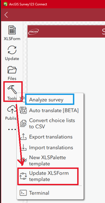

abureaux
MVP Frequent Contributor
Unless you have something preventing you from doing so, I'd recommend that both you and your co-worker uninstall the standalone version of Connect/Field App and instead go with the Windows Store Version (it auto-updates). Working on outdated software isn't a good practice.
Doug posted the solution to your question. I will add a couple things: Before updating the XLSX in Connect, You should 1) ensure Connect is up to date, and 2) Use the new(ish) "Update XLSForm template" feature, and 3) optionally using the "Analyze survey" feature may also be a good idea. After that, go ahead and update the XLSX and republish.
