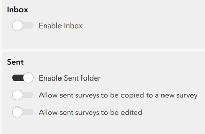

As @jcarlson alluded to, Device ID doesn't update once it has been set.
New survey on PC:
Editing a survey PC sent from phone via Inbox:
This is the case for a lot of those special hidden values. The one that annoys me the most is survey version not updating...
