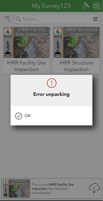

Hi,
I am having a issue with 2 public surveys.  These were both created using Connect and were working perfectly fine last week.  Yesterday I made slight updates to a domain choice field and republished using Connect Vs 3.11.124.  Now both of them are causing unpacking issues when the user tries to update on the field app.  The survey appears to download but seems to get stuck in a endless loop while trying to unpack.  I have tested this on a android phone, ipad, and windows laptop with the exact same results. Its a no go for the field user if you try to update the survey. From other posts it seems this may not be a new issues, has anyone had success fixing this problem???  Here are things i've tried so far.  I first tried updating the form to the latest version and republishing but this also did not resolve it.  Next I tried rolling back all my changes including the form update but that did not fix it either.

We're having the exact same issue with a survey form that is being called from a Field Maps map.  When a user clicks on a hyperlink in a Field Maps popup, it fires up an inspection report in Survey 123 using a custom URL scheme.  It was working a week ago, and now when we try it, it successfully opens Survey123 but gets stuck in the loop of "Unpacking", "Downloading thumbnail", "Downloading", until it times out and gives the 'Error Unpacking' message.
I've tried unistalling and reinstalling the app and clearing the cache, but it hasn't helped.  We have the same issue on iOS and Android.
