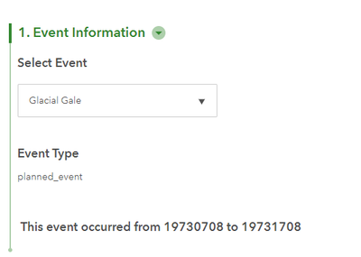

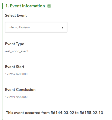

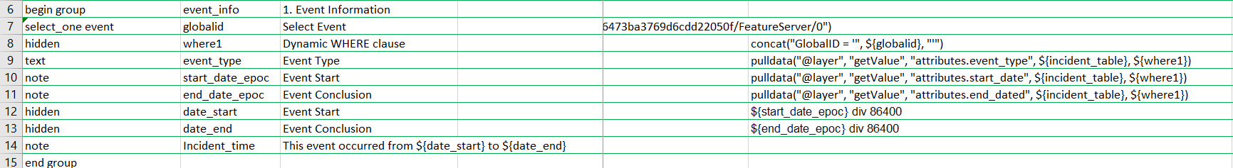

I am trying to convert Unix time to mm/dd/yyyy in a survey. I am pulling data from a feature layer into this survey using the pulldata("@layer"). I tried following this document but for some reason, my calculations are not population the correct date.

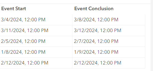

Feature Layer Dates I am pulling from:
Survey:

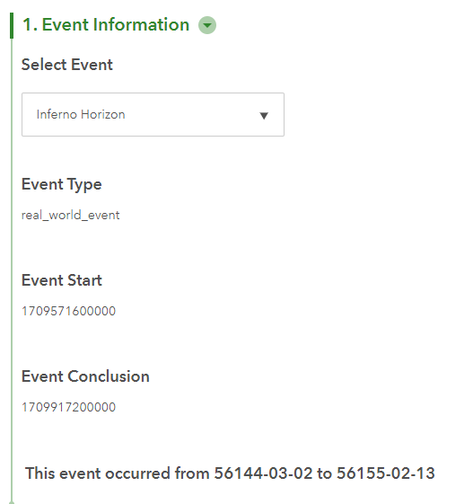

Web format:

On those 2 note fields that get the times try setting the bind:type column to int.  It will treat those note fields as string in the web app by default.  This usually leads to a cocat vs a +,  Never seen it on divide but worth a shot.

Did you set the bind on the hidden fields line 12 and 13 also?

@DougBrowning still getting some funky output after changing the blind type to int. Very puzzling why it won't convert.
