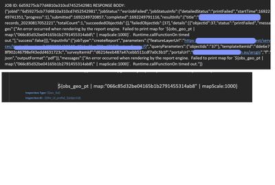

PeterMacKenzie2
I am using FME to call the reporting API. It works OK using a map in a simple report but not in my main prod report. I am getting some timeout json response - see screenshot - any ideas?
web map referenced in the report is simple, just a basemap. We are on Enterprise 10.8.1
errors of interest:
Runtime.callFunctionOn timed out.
An error occurred when rendering by the report engine.  Failed to print map for
