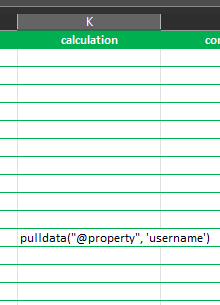

pmccord
That was it! I needed to add the following to the calculation field:
And then I had to add calculationMode=always to the bind::esri:parameters field:
Basically, it looks like I wasn't updating the 'theusername' field with the username of the person who was currently editing the form. Now that it is updating, the appropriate fields are readonly. Thanks again!!
