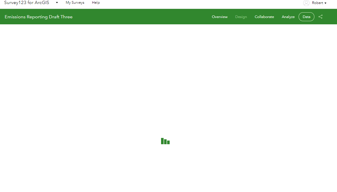

Currently I am unable to open up and view my survey data through the Data tab using the Survey123 web browser:
This issue is only occurring for one specific survey. I am able to access the survey data for my other surveys via the web browser data tab. I was hoping you could help me understand why this is occurring? Fortunately I am able to access my survey data through ArcGIS Online and can successfully download all the data as an excel spreadsheet. However, I would like to understand why I am unable to do so via the Survey123 web browser.

We have identified a couple of situations where the new custom printing functionality sees unexpected values and will be updating the website to address.  One situation is where a survey has a select_one question with only 1 choice (essentially, a confirmation question) - does the survey that does not load have such a question?  If not, could you share the XLS file to let us attempt to replicate it?

Yes my survey does have a select_one question with only 1 choice. Do I still need to send you my XLS file?

The select_one question with only a single choice item issue has been fixed on the website, can you please have a try after clearing the browser cache?

It works now. Thanks
