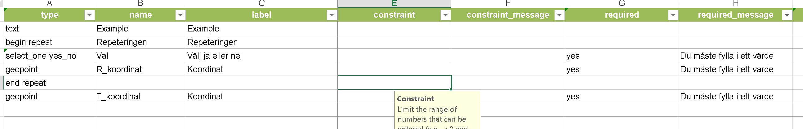

I have encountered a minor problem. When I add a geopoint in a repeat and makes it required - it is still possible to skip.
It works with other type of fields for example "Select one".

I have found a workaround.
By adding a required field that reads the accuracy (treshold=25 m) of the geopoint it is impossible to leave the repeat without a collected geopoint.
