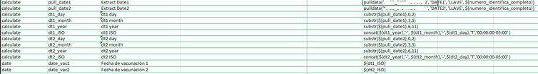

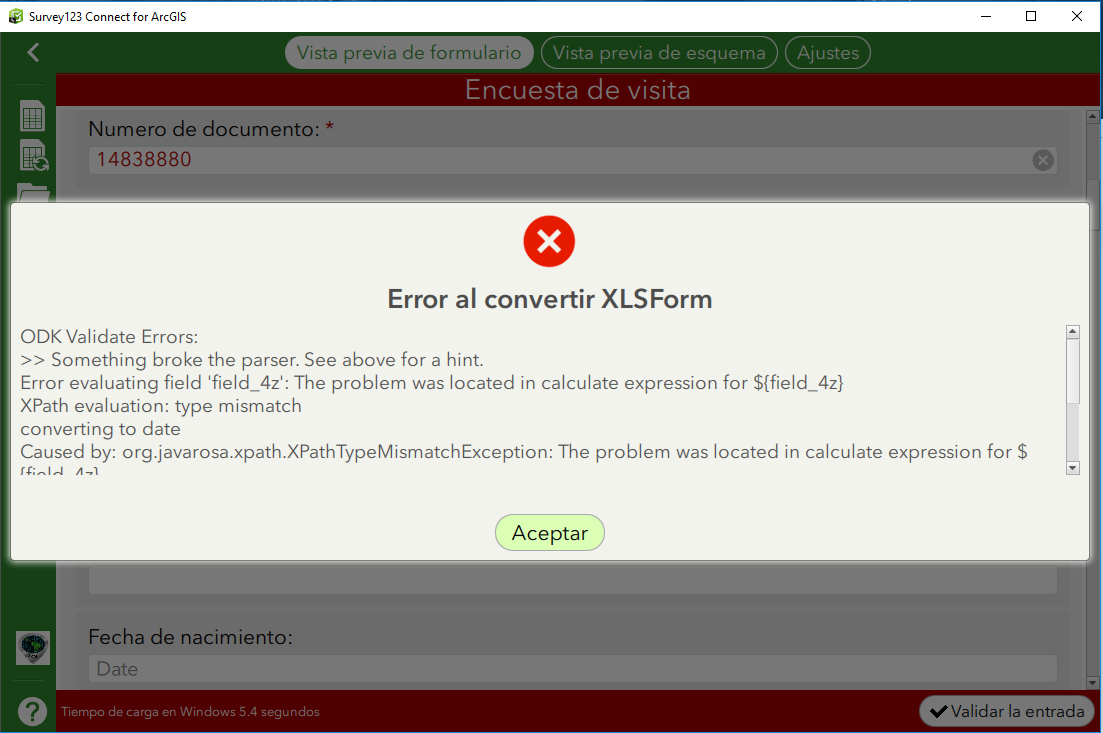

I have a database with some information of some people, within the birthday of them, but I want to convert this field that is a String into a Date (type field). For this, I am using the function date(). But I am receiving this error when I try to execute the sheet.
Here is the sheet extract:

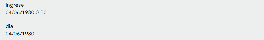

With results of the two first lines (field_4 and field_4a):

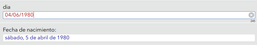

What I try to do in the field_4a is to subtract only the date of this data, so the function would work.
So I thought that with the result of dia (field_4a), the function date() could calculate the date field type because when I fill this field (4a) by hand it works!
Ok, it does not work perfectly (it subtracts a day but I can handle it), but at the least, the function read the string and converts it into a date. Have you any idea of what it is happening when I try to execute the first extract of the sheet that I showed to you? Thank you very much!

On the day being off - Survey123 uses UTC time and a date is stored as midnight; if you are located in the western hemisphere, the local time displayed will be the day before (as midnight UTC is still the previous day).
On the time calculation - I'm not seeing the behavior when I create a form with the formulas (excepting the pulldata function). Can you share a copy of the XLSForm that does not validate?

I had a similar problem and the only way to solve it was building the date in ISO format, like this:
it's a bit late, but it works,
