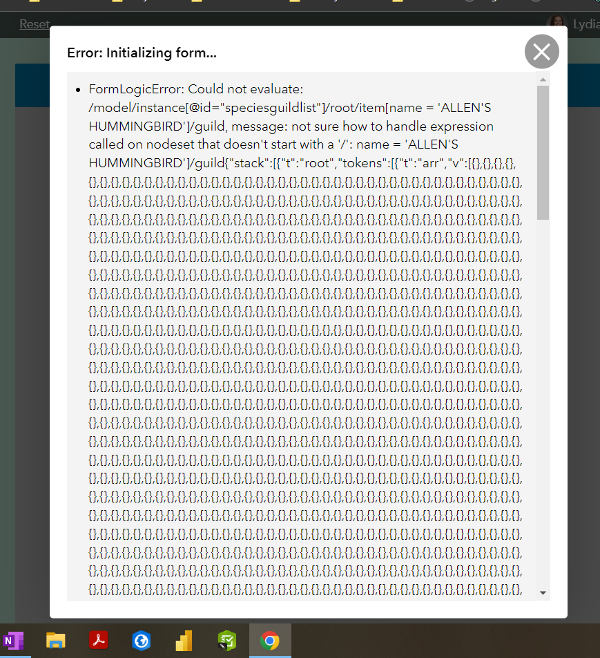

Phoning a friend for a very strange error message I am getting on a survey I created. I have a Creator level license. Hoping the brain trust has some ideas!

So, uhhh....I've never had an error quite like that before but I'll try to help (unless someone else more knowledgeable jumps in!)
So, looks like you're creating this survey in the web version rather than Connect, correct?
This is just a wild guess, but I wonder if that apostrophe in Allen's Hummingbird is causing an issue? That's an option from a select_one or select_multiple question, correct?

I also found these articles that reference the same "FormLogicError" message....perhaps there's something in them that could help?
https://community.esri.com/t5/arcgis-survey123-questions/formlogicerror-could-not-evaluate-model-ins...
https://community.esri.com/t5/arcgis-survey123-questions/formlogicerror-in-survey123-webapp-with-rel...

@Katie_Clark I have gotten this message intermittently between late last week and today. I created the survey in Connect, but was testing it out in a web browser. This is a select_one question as well. I have a separate CSV for this specific question (and another as well). I've attached my survey form and choices list.
