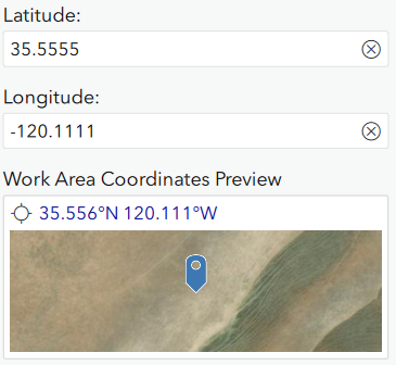

I could only come up with a workaround, which is to have the user enter Lat and Long into separate text boxes, then have those fields populate a read-only geopoint with a concat() formula.
However, this workaround takes away the convenience of using the map from those users that do know how to use the map properly. We'd rather turn off location services within this particular survey (not for the whole app though).
