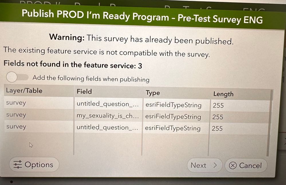

The existing feature service is not compatible with the survey using Survey123 Connect
3391
12
07-25-2023 10:20 AM
SeanRourke
I am getting this constant error when trying to publish the survey. I have looked at previous solutions and it did not work. Can someone help me with this error?

You have a survey created in the web app, which you have pulled into an old version of Survey123 connect. What @JayHodny suggested is on point. You need to upgrade Connect so that you have the latest Excel template. It seems like there aren't any issues creating a new survey with this form. However Jay and I can't target your feature service, which is what is getting flagged as incompatible.
The warning you are getting is indicating three fields in the form are not in the service. It is NOT an error. It's suggesting you need to add the fields to the service for these questions to be able to submit correctly, and asking if you want to do so.
However we cannot see these questions in your form. Have you provided the correct XLSForm? If not, then there is something going wrong. My immediate reaction is that you are on an older version of Survey123 Connect that is not compatible, or there is something wrong with your XLSForm. It will be difficult to revise your XLSForm if you have already been collecting data.
