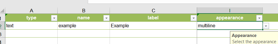

Is there a way to make the text into a block so that the input can be seen in a block as opposed to just it keep going across the screen in one line? The "type" "text" doesn't seem to have that option.

Hey Debra Crouse‌,
If you set the appearance field to multi line you will have that text block look.
