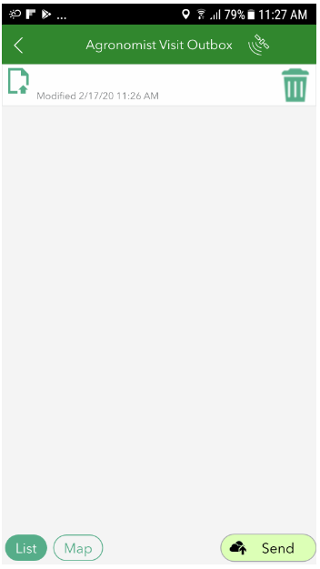

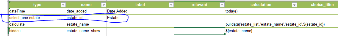

Would like to know if there is a way/work around to show the instance_name from a select_one value?
survey tab
settings tab
As seen from the mobile app, I could not see the values for estate_id and estate_name.
Hope someone can help me understand and let me know the workaround so that the instance_name will capture the estate_id and estate_name?

From your screenshots I can't see a reason why the instance_name is blank. Could you please provide your XLS and CSV files so I can attempt to troubleshoot?
Is the pulldata() function working correctly in the survey form?

Also I notice the labels for your 'estate' choice list are the same as the estate names in the CSV. In this case, instead of using pulldata() you could use the jr:choice-name() function to return the label for the choice. So the calculation would look something like: jr:choice-name(${estate_id}, '${estate_id}')
