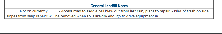

GISIntern21
My output look like this but I want it to be organized in different lines without the null values inbetween
abureaux
MVP Frequent Contributor
Use IF. IF on its own acts like an "if not null, do the thing". In practice, there are two uses of IF in this context:
  1. On it's own, the field will only appear if it contains a value. E.g., ${if field_83}
  2. As a full logic statement. E.g., ${if field_83}${field_83}${/}
I much prefer option #2 as you can add conditional formatting. Try this. It will conditionally show each "field_xx" on a new line if it contains data.
${comments}${if field_83}
${field_83}${/}${if field_85}
${field_85}${/}${if field_87}
${field_87}${/}
${comments_recommendations}
GISIntern21
Thank you so much it worked 🙂
