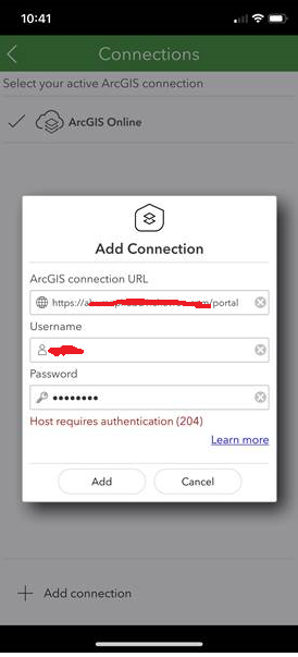

Hi,
When accessing our internal portal through the iOS Survey123 app we are prompted for the username and password to gain access.
Conversely when accessing the app via the desktop it uses Activity Directory, also if we access the portal page directly via the iOS phone it uses AD as well.
Username and password is not an option for our users, can anyone advise me on what can be done to use the AD authentication for our users when connecting to out internal portal?

Hello Elliott Carson‌,
This is as expected as only Windows can support Single Sign On when using IWA.
The reason for this is because the client computer needs to belong to the domain in order for the user to not be challenged for credent.... Since IOS and Android devices are not Active Directory aware clients users will need to enter their Active Directory credentials in order to authenticate.
I am a little unsure when you noted you can hit your ArcGIS Enterprise environment in a web browser it automatically passes along Active Directory credentials to log in. When I test this on my end I am prompt to enter my AD credentials in Safari and Chrome. Is the device configured to allow for active directory to be used and automatically submit credentials?
In your screen capture it looks like you are not connected to a VPN when accessing your ArcGIS Enterprise Environment, is your environment publicly available and configured with IWA?
