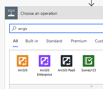

But for the actual operation, you will want to make use of Esri's Actions. Just type in "arcgis" and select either "ArcGIS" if you use AGO, or "ArcGIS Enterprise" if you use Enterprise. (NOTE: I highly recommend you follow these steps. Simply typing "Update a record in a feature layer" in the search field may not show you what you are looking for)
From there, use the action that best suits your task. That is likely going to be this one:
