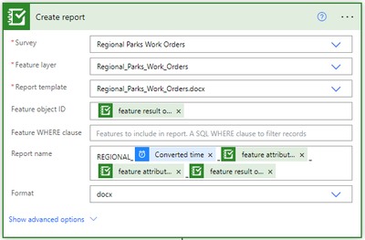

This is a fantastic guide @abureaux !
I wanted to drop a screenshot of mine using the AGOL Create report just to have that visible for people as well as the custom connector looks different.
I'm going to have to try the HTTP - Get Report to try and skip the OneDrive steps that Ismael has in his samples.
Is your jobStatus is equal to valid the return because of it being a custom connector for the create report? In my AGOL version I have it looking for esriJobSucceeded.
I am also very interested in knowing more about your 2 stage process for reliability, always going to be looking for ways to improve that with these services. Is this related to how sometimes the trigger from a submitted survey just never finds it's way to Power Automate?
abureaux
MVP Frequent Contributor
Thank you! I have only poked around AGO a few times so can always use more input regarding that process.
Good call on the "status" variable. That's what I also use, and intended to for this guide. Not sure why I grabbed status instead of jobStatus. Technically, status should work, but I feel that jobStatus is more appropriate (and intended) for this task. For anyone curious, there are two final "Status" in the Create Report step. One is jobStatus, which will either be esriJobSucceeded or esriJobFailed, and the other is status which will either be valid or not present. As I mentioned, the end result should be the same, but I will be updating the guide to use jobStatus as that is the intended parameter for this task.
RobertAnderson3
MVP Regular Contributor
I hadn't even caught that there was a separate status return on the create report function, I agree I think jobStatus is a better variable to look at, can process the esriJobFailed another way too if you want. I have my Create report in a do until loop with a count limit set just to try a couple extra times just incase the server randomly hiccups or something which I have experienced saving a couple runs.

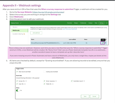

MichelleWilliamsERM
Thank you for your clear documentation for Power Automate.
Here's something we've learned along the way, you are welcome to add this to your directions in the future.
~~~ PLEASE change the name of your Power Automate Flow in the screen below, so you don't over write it when you build a second flow, PLUS you'll know which flow is which.
We found that if we didn't update the name, then Power Automate overwrites Flow 1 with Flow 2.
May the surveys always be in your favor!
abureaux
Power Automate has been overwriting your Webhooks in the Surveys Site? That isn't normal behaviour, but I've both heard of and seen it happen in the past. Essentially, Esri's service only allows a single webhook created by Power Automate at a time. Honestly, I don't recall there being a specific fix for this issue when it last appeared. It kind of just came and went on its own. But that behaviour isn't normal or intended, so it may be worth pulling in support to at least log it as an issue?
However, if you are able to rename the webhooks to bypass the limitation, than that sounds like a good workaround.
MichelleWilliamsERM
Renaming the file works for us, we have several flows on one hosted service. We use this when we are building out a second flow and need to keep the first one intact for LIVE data.
