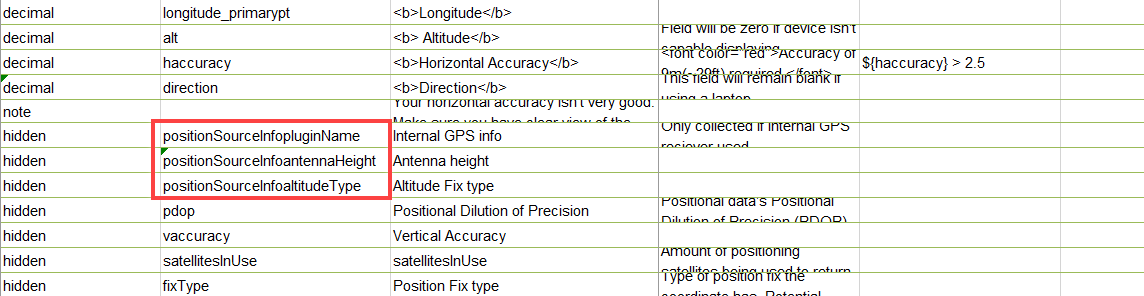

Apologies for the delayed response. I was able to reproduce this issue with your form on my end.
I noticed that in questions 31-33 we have a '.' between positionSourceInfo and the subsequent text. Note in the types sheet of the .xlsx form that a dot is listed as a special character, which cannot be used in the name field of a question, or the name field of the choices page.
Once I removed these dots, I could submit responses to the survey successfully. You can use an underscore in place of the '.' symbol, but I simply removed it from your form which worked well.
