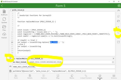

I appreciate all your help! I am still working on making this all make sense. Below is what I have currently and its no working right now. If you see anything thats wrong please let me know! If you need anything further from me or have any follow up questions please let me know!! I really appreciate it!
LaurenceTait
There is a minor glitch in your code at Line 10. Should be const issuesString = issues.join (', '); and you have const issuesString = issues.join ('', ' '); But that won't stop it from working.
What do you mean when you say it's not working? Are you getting an error message in the script compiler, or when you save the xlsx sheet, or something else"
What happens when you test your code? Click the "fx" button on the scripts page, then copy in one or two of your choices from the worksheet, separated by a comma ",". Then click the execute button ">".
I've tried to replicate the sheet and code that you are using, and it works fine. I've attached the files below. Try those and see if you can get them to work, then you can use that as the basis for your own suvey.
If you upload your xlsx sheet and your js code, I'll try it at my end and see if it works. That might be the fastest option.
Cheers.

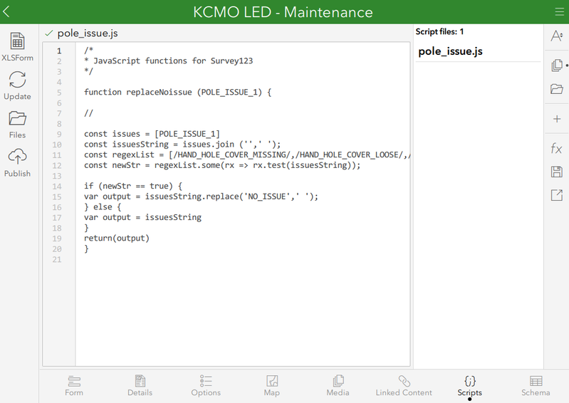

Sorry for the confusion, when I say its not working - When I go to my Pole Issues list and click another from the select multiple, it is not unselecting the "No Issue" that is defaulted. Hope this clears up what I mean. I attached the xlsx and .js below.
LaurenceTait

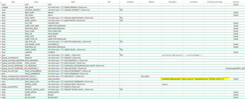

Two minor problems.
You have the [relevant] field for [held_condition] set to “false". Any field that is not relevant has the value set to null, so the held condition field can never store any values.
The other problem is that you have only added the first 4 of your 11 issues to your javascript finction, so the function will only work if you select one of those 4. Add all 11 to the function and it will work fine.
