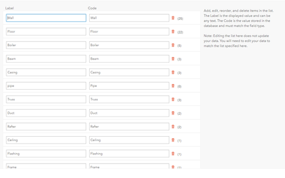

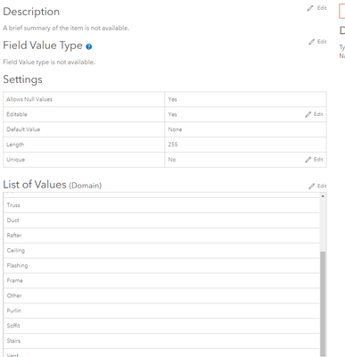

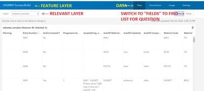

edit: If you created your survey in the web designer, it may not be obvious to you that you have a name and label for your list options (or "Label" and "Code" when viewing in your AGOL Feature Layer details).
Here's a few screenshots on where to find that, assuming you don't see your name/code values otherwise (note that in my example, the name and the code match exactly. I try to do this on purpose, but it's usually not going to be the case)
