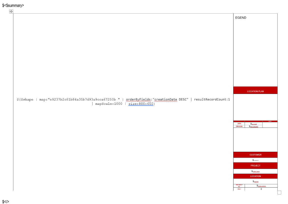

I am trying to create a survey report containing a map that displays the geopoints collected in a survey. So far I can create the report however all of the points in the layer on the web map are displaying. As a note, the geopoints are contained in a repeat.
I am trying to play around with the summary section however I keep getting errors about end nodes being in the wrong place etc. I am hoping to filter the points by creation date as shown in the snippet below.
I was thinking maybe a need to have a new web map that shows a filtered version of the points via SDE? I haven't really played around with that so not sure of the capabilities.
