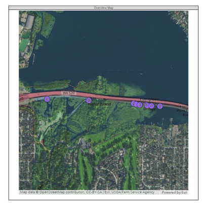

I just came here to post this idea too. Just to make sure I'm asking for the same thing, here's the general idea:
This is currently possible with the feature report syntax:
${ proj_extents_geoshape | drawingInfo:"currentLayer"| mapSettings:" b2519fd7a45647a0946f50b0535b6ddd" | size:175:250:0:0}
and I would like something like this available in the feature report:
{ proj_extents_geoshape | drawingInfo:"currentLayer"| mapSettings:" b2519fd7a45647a0946f50b0535b6ddd" where:ParentGlobalID=${pguid} | size:175:250:0:0}
Currently, I have the referenced basemap set up to filter points (geopoints contained inside a repeat) to only be displayed if they have been edited in the last 15 minutes.  This works well enough for most submissions when the report is generated automatically via the integromat process.  If I have to generate reports manually (such as someone submitting a partial survey, then editing it and resubmitting later), first I need to open the web map and change the filter to filter all points to the layer 0 record's GUID.   There's other use cases I can think of where URL parameters being available in the feature report would be very helpful, but this seems like the most common one.
