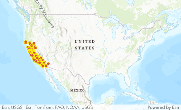

  • ${$map | map:"7f2ef03be73a4b51b9e0480df46de7b1" | mapFilters:"where=STATE_NAME='California'"} - prints only the cities where the STATE_NAME attribute equals "California". Note that the text in the where clause must be enclosed in single quotation marks ' '.

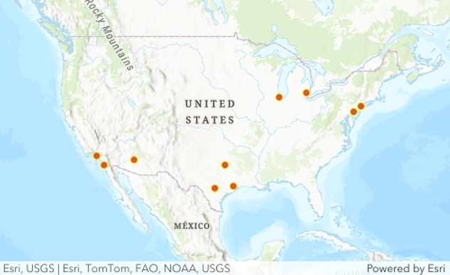

  • ${$map | map:"7f2ef03be73a4b51b9e0480df46de7b1" | mapFilters:"where=1=1&orderByFields=POP2000 DESC&resultRecordCount=10"} - prints the first 10 cities with the highest population in the USA on the map.

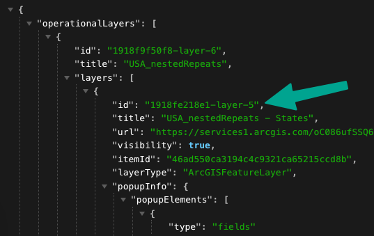

If a web map contains multiple operational layers and you want to filter each one, you need to specify the layer id in web map JSON for each feature layer and concatenate all layers using a colon `:`. The format is {... | map:"<itemId>" | mapFilters:"'<layerId1inWebMapJSON>':<parametersForQueryOperation>":"'<layerId2inWebMapJSON>':<parametersForQueryOperation>":...}.
For example, imagine a web map that contains two layers: a layer of states and a layer of cities in the USA, where the cities layer is related to the states layer via the parentGlobalID field. In the web map JSON:
1918fe218e1-layer-5 is the layer ID for states, and 1918f9f547a-layer-4 is the layer ID for cities. e4a6f9ce-bc61-428c-8c26-202ff62e509e is the global ID of California in the states layer.

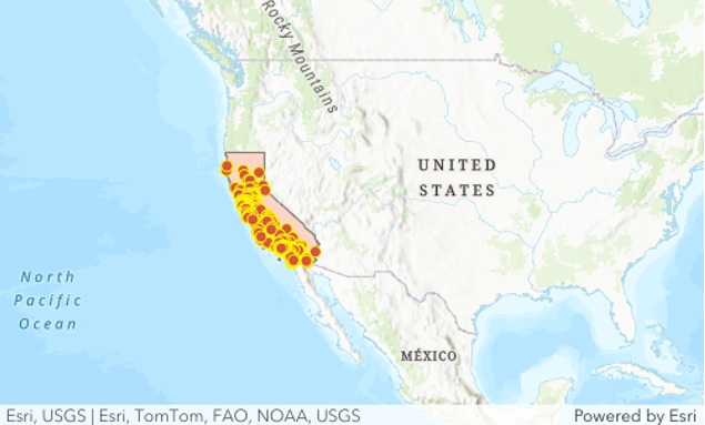

  • ${$map | map:"7f2ef03be73a4b51b9e0480df46de7b1" | mapFilters:"'1918fe218e1-layer-5':where=GlobalID='e4a6f9ce-bc61-428c-8c26-202ff62e509e'":"'1918f9f547a-layer-4':where=parentGlobalID='e4a6f9ce-bc61-428c-8c26-202ff62e509e'"} -  prints the state of California and all cities related to it on the map.
  • You can replace the static global ID value with its field name in the states layer. In this case, when you select any state as the input for the report, its global ID value will be dynamically replaced in the placeholder, allowing the map to display the selected state and its cities: ${$map | map:"7f2ef03be73a4b51b9e0480df46de7b1" | mapFilters:"'1918fe218e1-layer-5':where=GlobalID='"+GlobalID+"'":"'1918f9f547a-layer-4':where=parentGlobalID='"+GlobalID+"'"}
