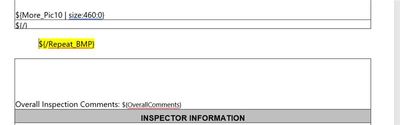

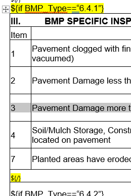

  2. The repeat's open tag is written outside the table and the close tag is inside a table. This is problematic to the report service since the report service does not know how to deal with repeat instances. If the open/close tags are written outside the table, the repeat service will duplicate the entire section between the open/close tags for each repeat instance. If the open/close tags are written inside the table, the report service will duplicate the table rows for each repeat instance. I move the close tag outside of the table to fix the issue, see screenshot below. With this fixed, you will not see the error raised for OtherM which is the question before entering repeat.

Original template
Updated template
With these 3 issues fixed, your report should be generated correctly. Other than that, you may also need to place the open and close tags if outside the table.
