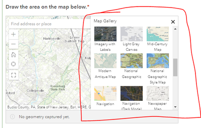

Hello,
I'm creating a survey using Survey123 Connect and I would like to limit the basemap options for a Geopoint question to a few or just one basemap. Is this possible to achieve in Survey123 Connect?
Thanks.
Richard_Purkis
@DaveK It is not possible to manually limit the basemap choice list as such. As mentioned in the documentation, the list of available basemaps is populated by your ArcGIS organization's shared basemaps.
If you want to see the ability to limit available basemaps I recommend you raising this as an idea.
