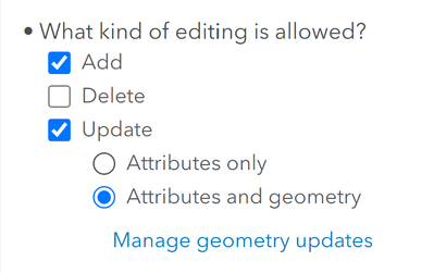

can you share the editing settings of the hosted feature layer they are submitting to?
Sounds like the layer/view has permissions to 'add' but not 'edit', and it'll be hard to offer any other advice until we can confirm it's not the case
JarrodLoerzel
Thanks for the reply. Below are the settings I have for the layer and the view.
View settings:

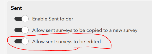

Have you set this in Connect?
JarrodLoerzel
Thanks Doug,
I don't have the Sent folder enabled in Survey123; I do have the inbox enabled and they can edit the surveys via the inbox. They just can't edit them in the web-based Survey123 under the Data tab.

DanielMurillo
I had the issue that an Admin was able to send surveys from Inbox folder and the Mobile Workers could not. After checking the logs on the app, we saw this:
"code": 400, "details": [ "'edits' parameter is invalid", "Geometry update not allowed.", "Unable to apply edits."
Checking the service, it the Advanced Settings it had checked the option to 'Update Attributes Only' and not the 'Attributes and Geometry', by checking this last one we were able to send surveys with Mobile Workers.
Just in case anybody is having the same issue.
