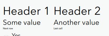

And lastly, because it appears that you're trying to output a table of sorts, you can attempt to use the HTML <table> tags in S123, though you don't have nearly as much control over how they display.
<table style="padding:5px; border:1px solid black; border-spacing:5px;"><tr style="font-size:38px"><td>Header 1 </td><td>Header 2 </td></tr><tr style="font-size:24px"><td>Some value</td><td>Another value</td></tr><tr style="font-size:8px"><td>Next row</td><td>Last cell</td></tr></table>
 Note how the padding and border styling on the <table> tag is ignored. But text styling per row is possible.
