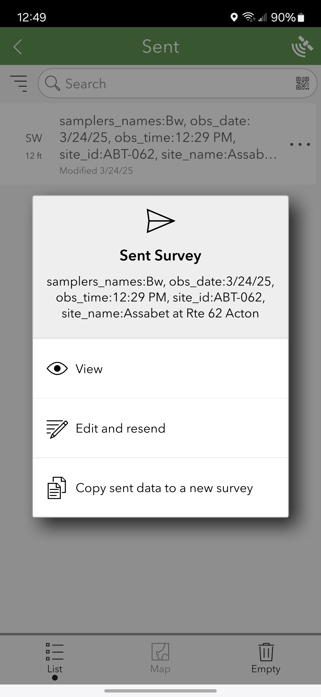

Is it possible to remove the Edit and Resend option in Survey123? When you use Survey123 in the app, after submitting a survey, all submitted surveys are listed in the Sent box in the app. If you click on a submission entry, you get the following options: view, edit and resend, copy data to a new survey. Is it possible to remove or deactivate the edit and resend option for all users? When anonymous users click it and try to edit an entry, they get an error and the survey moves to the Outbox. This is annoying and confusing for users. I would like to just turn off the edit and resend option.

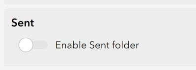

In Survey123 Connect, you can disable the Sent folder. This will prevent the end users from being able to see any of their sent items.

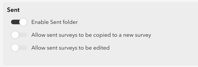

Alternatively, you can keep the Sent inbox enabled, but disable the ability to copy sent surveys to a new survey, or disable the ability for sent surveys to be edited.

This is exactly what I'm looking for "Disallow sent surveys to be edited". Where is this setting? I can't seem to find it anywhere.

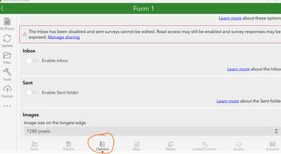

Assuming you're using Survey123 Connect to publish your surveys, open the survey in S123 Connect. Then click the Options tab at the very bottom. And from there, you will see the Sent folder options.
