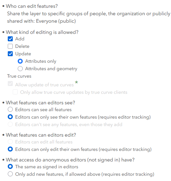

I have created a Survey123 survey.  I have set the same public sharing settings for the three feature layers that were created:
regular, _form, and _results
For all three, I have set the settings to allow anybody to create and edit their own features.  But, when I try to anonymously edit a feature that I have anonymously created in the Survey123 app (on Android), I get an error message saying "This survey could not be sent due to the following error: _".  No error is described.  Here are my settings:

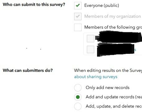

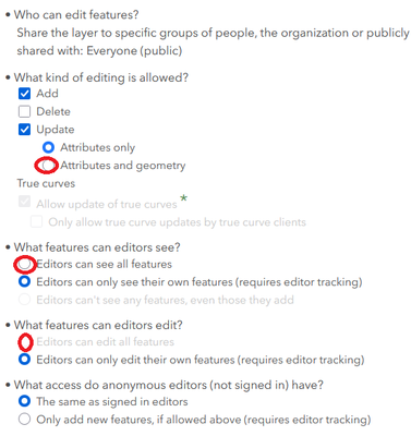

hi Ben,
If you want anonymous users to submit records to your survey
then checked (red circle) the following (see attached)

hi Ben,
BenjamenWetherill
That works. I guess that must mean that the editor tracking does not work for anonymous users.
