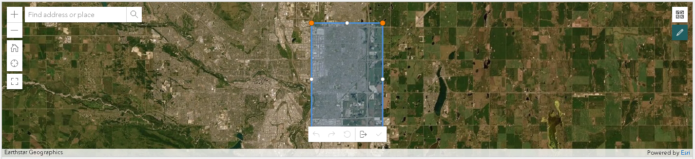

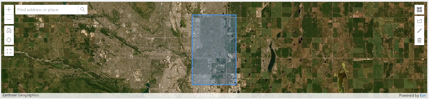

Now, when surveys are opened in a 'PC', the interface is quite intuitive and allow users to click a button to start the edition, move the vertices, undo/redo, reset the changes, exit without saving, exit saving changes... all is good (see 2 images below):

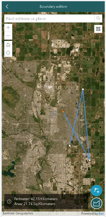

However, when I open the survey in a mobile device, this is the interface that I get. No matter what tool I use, the existing geometry is gone, and I can only (and hardly) create a new geometry from scratch.
