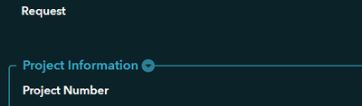

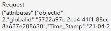

The images below show the reusult of my javascript request in the mobile app vs. web browser.
pulldata("@javascript", "getProjectDetail.js", "featureByAttribute", ${Project_Name}, ${Token}))
 Result in the mobile app
Result in the web form (empty)
This is what I did for scripting,.. sorry for poor coding. I hope to get some advice.

I used a query page to get the accurate url pattern that I'd like to apply. I noticed that there was '+' for space, so I applied that in the url scheme in the Javascript file.
After I fixed, it will look like this (Project_Name = 'Sample Project-Phase1'). To confirm, I coped and pasted the url in the browser, and I could see the json return, just like shown in my mobile app and Connect.  However, it still shows nothing in the webform.
https://services1.arcgis.com/../FeatureServer/0/query?where=Project_Name+%3D+%27Sample+Project-Phase...
Should I pass x, y to get the json return in web form like the featureByLocation code sample in the Connect? I am still not clear what makes different in my javascript pulldata.
When I checked the development tool, it shows the error below. Does it indicate the error that I have,,?
"DevTools failed to load SourceMap: Could not load content for chrome-extension://.../sourceMap/chrome/content.map: HTTP error: status code 404, net::ERR_UNKNOWN_URL_SCHEME"
