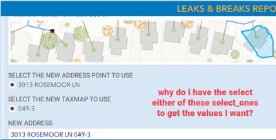

ahargreaves_FW
@HeatherBell this was helpful, thanks. I have the exact same issue:
  • Use a GeoShape to draw on a map and grab an intersecting point's ID
  • Thanks to you I can now automatically submit that ID into a second search a pull back a second attribute for the matching record.
  • However, in order to be able to actually use that second attribute the select_one must be selected by the user....
@IsmaelChivite , @JamesTedrick , @ZacharySutherby , @BrettStokes , @Shwu-jingJeng   is there any way around this?
