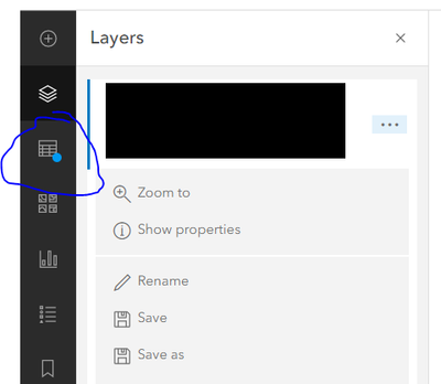

Key details:
  • Survey123 Connect 3.17.55
  • Publish new survey form with a point layer and repeat (no geometry in the repeat). Have tested multiple surveys and devices. No keywords or shenanigans.
  • Add created feature layer to Map Viewer
  • Click layer options... no 'table' option for the point layer

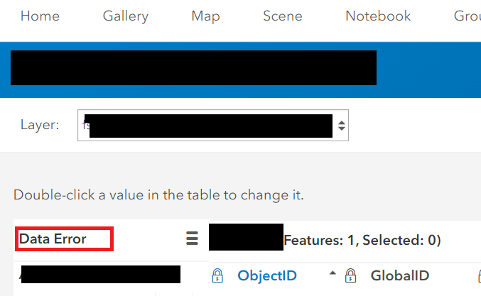

  • Click 'show related records' in the item overview data page and it returns 'Data Error'
  • The table appears:
    • In Map Viewer Classic
    • In the Map Viewer pop-up
    • For the related table (no geometry)
    • In a View layer of the same service, in Map Viewer
Is this a known issue? Bit concerning if the new Map Viewer isn't friendly with simple surveys or there's something else going on with the tables created by survey

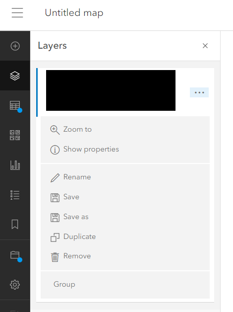

I'm the admin and owner of the feature service. Adding to a new Web Map. The table option is not available for the point layer in the service. The related table is (under tables, not layers). Hosted Feature Layers not created through Survey123 are fine. A hosted feature layer view of the same problematic layer has the table option.
Simply put, a feature service created with Survey123 doesn't give the option to open the attribute table from the layer in Map Viewer.
Looking like a defect...
JoshuaSharp-Heward
I checked at work today and I found the exact same behaviour for a hosted feature service created by Survey123 - so definitely seems to be a defect.
