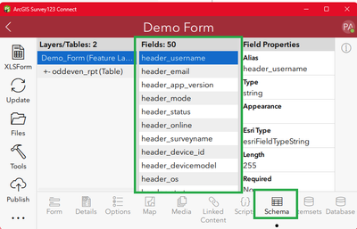

  • When referencing fields in your survey, you must reference the field name. To get a field name you can either open the XLSX and look in the name column, or go to the Schema tab in Connect and look in the Fields column (note: if using this second approach, you many need to swap between layers/tables using the Layyers/Tables column).

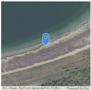

  • ${fred} will result in an image being added to the Feature Report with the location.
    Result is:
    This is pretty useless most of the time.

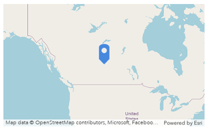

  • ${fred | mapSettings:””:5000} zooms to a scale of 1:5000.
    Result is:
    Much better!

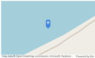

  • ${fred | mapSettings:”667de8a61b50499f96ae11c3fb7aa6ff”:5000 | size:350:350} Uses a specific basemap, sets the scale to 1:5000, and sets the images size to 350:350. This is the best way to display a geopoint IMO.
    Result is:
    ${Fred} is looking beautiful now!

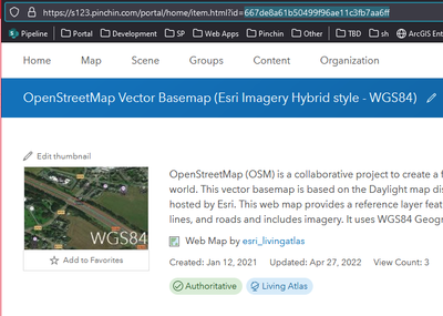

If you are curious where the map ID comes from (e.g.,667de8a61b50499f96ae11c3fb7aa6ff), you can either get that from any map you publish to your Portal, or from the Living Atlas. Just go to the map and copy the Map ID from the URL bar. E.g.,

And just to confirm. In Connect, when you go to the "" tab, do you see "location"?
If you don't see "location" in this list, here are some common issues:
  • You forgot to republish your survey, meaning "location" isn't in the Feature Layer yet.
  • You set bind::esri:fieldType to "null", meaning "location" will not be added to the Feature Layer.
  • Your field is located within a repeat. While "location" has been added to your Feature Layer, it was added to a related table, meaning you need to reference it differently in the Feature Report.
