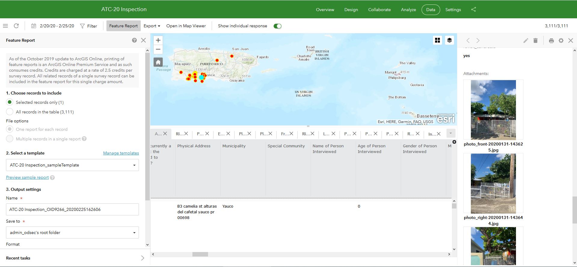

I’m having issues with Survey123 Feature Reports, In particular I’m unable to get images to be included in the generated report.
The hosted feature layer used for Survey123 Feature reports contains around 3000 features that were imported from another Feature Layer( from an old version of a Survey to collect data from affected structures on January earthquake in Puerto Rico). The import was successful, These records preserved their relationships and their attachments.
On the Feature Reports page, it can be appreciated that for the selected feature, photos are available (Attachment1.jpeg)
However, when I use the default template(1), (and a custom made template), photos are not included either on the Preview document(2), nor in the generated document.

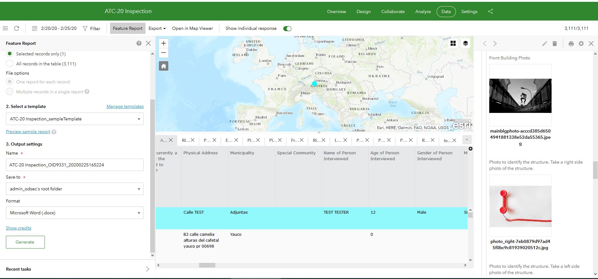

For new records collected using survey123, Photos can however be seen both in the Feature Reports page(3), and in generated report samples(4).

Attachment1     -> Screenshot of Survey123 Feature Reports  Page, demonstrating existence of pictures in the Feature Layer.

(3)                          -> Screenshot of Survey123 Feature Reports  Page, demonstrating existence of pictures in the Feature Layer. (Attachment2.jpg)
(4)                          -> Preview Document Generated using Survey123 Feature Reports, but pictures are available. (ATC-20 Inspection_OID9331_20200225165333

We had a survey with photos, these photos were not on a repeat. So we create a new survey (with the exact same fields) we just add a repeat for certain fields. So we download the data from survey 1 on a FGDB, then using ArcGIS Pro we use the service from Survey 2 and with append tool we upload the data with the photos. 3K points with 24k attachments ( 8 fields with photo option). Then when we check this in survey123.arcgis.com we can see the photos on the right side, but when we create the preview or the actual report (default layout or one we create) we are not able to see photos in it.

Yes, the photo is labeled with the question they were taken.. As you can see the image, the photo is there, if we select one of the 3k points. but the attachment name looks like a date
compere with new points, the photo name is really random and long. as shown on the preview.
