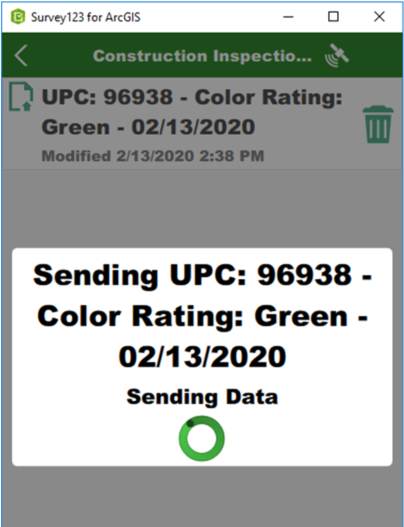

We have a survey published to ArcGIS Enterprise and targets an existing feature service.   When I add a new data from Survey123 Windows(Version 3.757), the data posts to feature service just fine, but the screen gets suck in the "sending data" message.  The only way to get out of this is to close and re-open the app.  When I check the log in AppStudio, it shows applyEdit processed successfully.
Interestingly, if I post data from the web version of Survey123, it does not hang.  Does anyone have any suggestions on what I can try to troubleshoot this?
