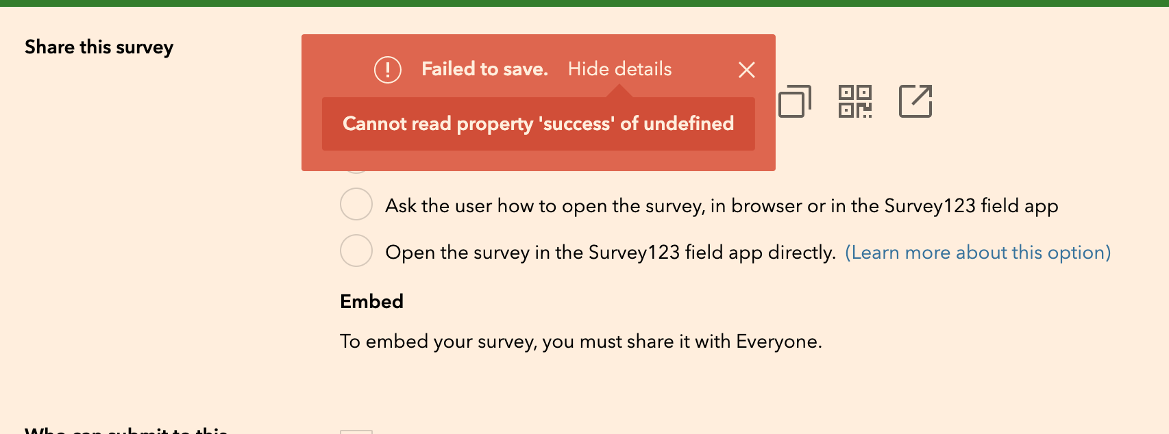

Hi there,
I'm experiencing an issue with an error code I'm receiving whenever I attempt to save new permissions for my surveys. I get the following error code: "Failed to save. Cannot read property 'success' of undefined".
Ultimately, when we back out of this page and navigate back to the My Surveys view, the new permissions are saving - so it's not stopping us up. However, we have multiple people creating surveys this way and it's making people a little nervous that the guys in the field aren't going to be able to access the surveys.
Is there any way to remedy this?

DrewThompson
Hi Shwu-jing Jeng,
Thank you for responding. I navigated to the Settings>Version and the option for "Always use the latest version" was already selected. I tried re-publishing the survey and I am still receiving a similar error message when I attempt to save the collaboration settings. Do you have any other recommendations for how to fix this issue?

I managed to solve the issue by clearing the browser cache data in the browser (your firefox or google chrome)

I cleared the browser cache data and I was abble to publish my survey, thanks

I had the same error today. Cache clearing allowed the save to occur.
