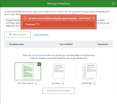

Having issues saving report templates in Survey123.
I've tried my existing templates as well as the sample templates, but the same error occurs when saving.
Anyone know why this error is occurring?

I'm also receiving this same error. Occurs when selecting Individual record, Summary, or Combined template.
Survey resides on AGOL and was originally published from s123 connect (3.14). https://arcg.is/1CLX1C1

We were able to solve this problem.
Manually created a word doc form, loaded form into s123 manage template. Was now able to run the error report. This is where the FieldTypeString error now appeared. Bind types: syntax changed for Date and Text.
After removing or changing the the values/syntax in the Bind field, the error went away.
