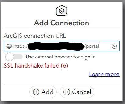

I am a co-worker with Jay and am seeing the same issue with 3.15.  I tried logging in to our Enterprise portal and got the following error message when trying to add our Enterprise connection:
I tried both with and without using an external browser for sign in and got the same error.

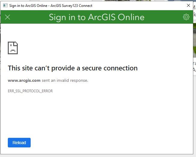

And this is the error we get when trying to log in through ArcGIS Online:
We don't even get to the screen where it askes for our AGOL credentials.

Typically the SSL handshake failed error is due to an untrusted certificate with the ArcGIS Enterprise environment. The ArcGIS Online error makes me think a proxy issue but since both environments work in 3.14 I want to hold off on going down those paths.

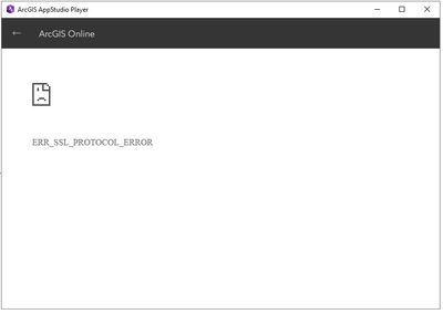

Currently I only see AppStudio Player 5.3 available to download and we are getting similar errors when trying to log into that:
For AGOL:

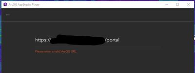

For our Enterprise URL it will not even recognize it as a valid URL, even though I quadruple checked that it is correct:

EDIT: I saw that AppStudio 5.4 was available this morning so I installed it and tried it, got the same errors as above.
