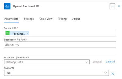

However, after trying everything from this tutorial, I am still receiving an error at the "Upload file from URL"  (3rd step). Does anyone know how to overcome it? Or if there is a workaround?

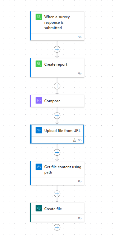

Below is how my flow is currently structured:
Thank you in advance!

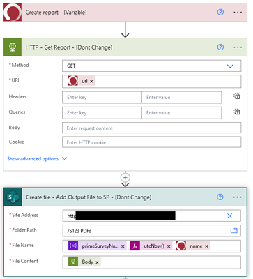

1. To resolve your report issue, maybe try an HTTP Get after the report generation. Then, Use that HTTP step to upload:
In my example, I am uploading to SharePoint. You can just replace that with One Drive.

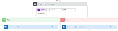

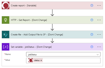

2. The Create Report step is a self-contained Do Until. It will always "Do Until" a report is created. The issue is that it always succeeds even if report generation fails. As such, I would add this:
Just be sure to choose this "status":
Then, use a Condition. You want all of your flows "bulk" to be in the "yes" side of this condition.
This is a simplified version of my flow, but really the most important parts.

Hi @abureaux ,
Thanks for the suggestion. But when I try to replicate your first recommendation Power Automate automatically adds a "for each" condition to the HHTP GET (I use the "url" from the create report action to populate the field). Do you know why and how I can work around it?
