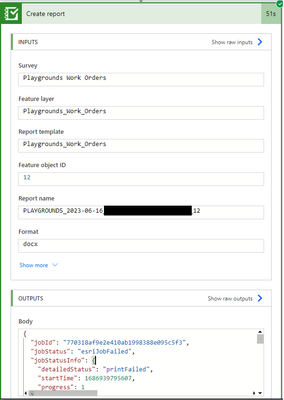

However, I am finding on an unfortunately regular basis that the report isn't returning any results?
The action Create Report itself marks as "Successful" but then the "Upload File from URL" action fails because "A value must be provided for source path" so when I look further into the "Create Report" I find it has returned an error, a few different ones 'Internal Server side error' (I think this was Esri server errors mid last week) or 'Error assembling data' or 'Error querying data'
But when I run them again, without making any changes to the data or webhook, they work without an issue.
I'm curious if there's something I'm missing (other than a try-catch to run it again if the output is an error) or why the Create Report action marks as successful when it has in fact failed.

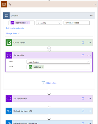

I did end up going another way with it for the Create Report action and I THINK this should work too? A little simpler because I can work with dynamic content instead of the whole JSON.
I initialized a variable reportSuccess and in a Scope (Try) I added a Do Until where the Create Report runs, and then updates the variable based on the jobStatus return, so it will run until it is esriJobSucceeded
I then included the rest of my actions in the Try, and the last step I have outside of the Try is Send an Email with the Configure run after set to failed, skipped or timed out.
I also have the reportError variable which just accepts the body of the return from Create Report and puts it in a text file attachment to my email. My only issue with that right now is it doesn't retain any structure so it's just a big block of text. I'd love to parse the return for the error messages themselves, but it looks like the return changes depending on what happened so I'm not sure how to do that with consistency.

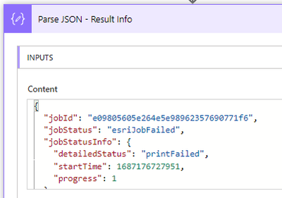

This step failing is where I see 100% of these random errors. In fact, I had a flow fail just this morning:
(It automatically reran and was successful)
In my case, I have error handling set up in the flow. Basically, if there is an error, the flow will reset and run again. I have never seen one of these mystery errors happen more than once in a row, and only at a frequency of every (very rough guess) 1/50 to 1/100 submissions.
Honestly, if you are experiencing the same thing as me, I don't think Esri support can help. The errors are far to transitory to analyze. I would suggest going the same route as me with the multi-stage report generation.

So basically the Action still runs and gives the little green checkmark saying it worked, it returns status code 200 either way at the end.
So it knows, it just powers through it and it's on me for not catching it. Can you set a delay on the do until to try again?

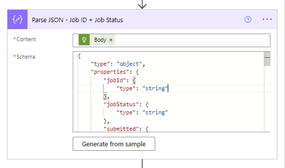

Here are the components (starting at the first Parse JSON):
1. Parse JSON - Job ID + Job Status
Body = The previous "HTTP - Create Report" in my first screen cap (so, probably your Esri Create Report Action?)
Schema =
    "type": "object",
    "properties": {
        "jobId": {
            "type": "string"
        "jobStatus": {
            "type": "string"
        "submitted": {
            "type": "integer"
        "resultInfo": {
            "type": "object",
            "properties": {
                "title": {
                    "type": "string"
        "inputInfo": {
            "type": "object",
            "properties": {
                "jobType": {
                    "type": "string"
                "parameters": {
                    "type": "object",
                    "properties": {
                        "featureLayerUrl": {
                            "type": "string"
                        "queryParameters": {
                            "type": "object",
                            "properties": {
                                "objectIds": {
                                    "type": "string"
                        "templateItemId": {
                            "type": "string"
                        "portalUrl": {
                            "type": "string"
        "success": {
            "type": "boolean"

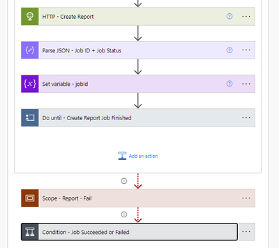

2. Set variable - jobId
ValuejobId from the previous Parse JSON

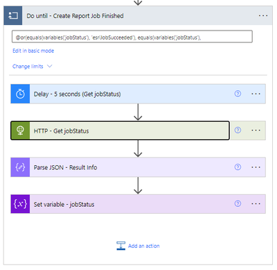

3. Do Until - Create Report Job Finished
3a. Do Until's Logic. Must be entered in Advanced mode.
@or(equals(variables('jobStatus'), 'esriJobSucceeded'), equals(variables('jobStatus'), 'esriJobPartialSucceeded'), equals(variables('jobStatus'), 'esriJobFailed'))

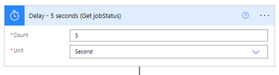

 3b. Delay - 5 seconds (Get jobStatus)
Simply a 5 second delay. This helps the Loop run smoothly.

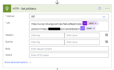

3c. HTTP - Get jobStatus
This one will be interesting... JobId you already have from above. But Token I set previously. Not sure how to best accommodate that.

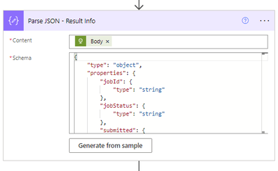

3d. Parse JSON - Result Info
Body = Previous HTTP step
Schema =
    "type": "object",
    "properties": {
        "jobId": {
            "type": "string"
        "jobStatus": {
            "type": "string"
        "submitted": {
            "type": "integer"
        "completed": {
            "type": "integer"
        "resultInfo": {
            "type": "object",
            "properties": {
                "title": {
                    "type": "string"
                "totalCount": {
                    "type": "integer"
                "resultFiles": {
                    "type": "array",
                    "items": {
                        "type": "object",
                        "properties": {
                            "objectIds": {
                                "type": "array",
                                "items": {
                                    "type": [
                                        "integer",
                                        "string",
                                        "number"
                            "name": {
                                "type": "string"
                            "size": {
                                "type": "integer"
                            "url": {
                                "type": "string"
                        "required": [
                            "objectIds",
                            "name",
                            "size",
                            "url"
                "succeededObjectIds": {
                    "type": "array",
                    "items": {
                        "type": "integer"
                "failedObjectIds": {
                    "type": "array"
                "details": {
                    "type": "array"
        "inputInfo": {
            "type": "object",
            "properties": {
                "jobType": {
                    "type": "string"
                "parameters": {
                    "type": "object",
                    "properties": {
                            "type": "string"
                            "type": "object",
                            "properties": {
                                "objectIds": {
                                    "type": "string"
                        "templateItemId": {
                            "type": "string"
3e. Set variable - jobStatus
Value = jobStatus from previous Parse JSON step.

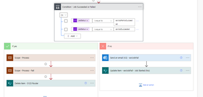

4. Condition - Job Succeeded or Failed
This Condition is probably the most important part. If the report doesn't print, it goes to the If no branch, which resets the flow. If the report does print, it hits the If yes branch, and does whatever the next steps are.
I also added a direct link to the flow run that failed in my email so that's super handy, and maybe easier.
