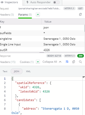

Using Fiddler, I can see the Survey123 app parameters and response:
Does the workflow make sense?
If so, how does one reversegeocode with find address candidates in the excel form using pulldata?
