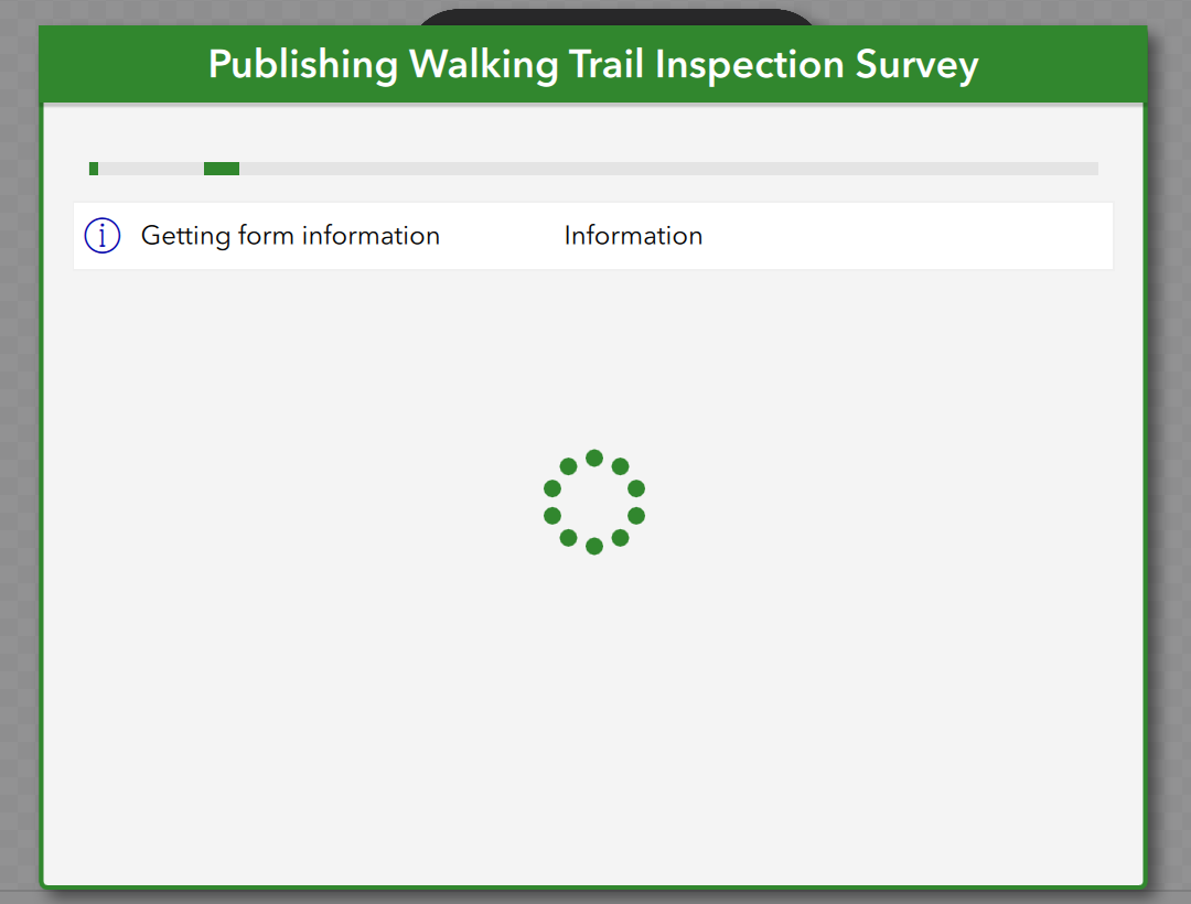

I recently changed the ownership of an existing Survey123 Connect survey and now need to publish a couple of changes. When I go to publish the changes the survey gets stuck on and doesnt move past this screen:

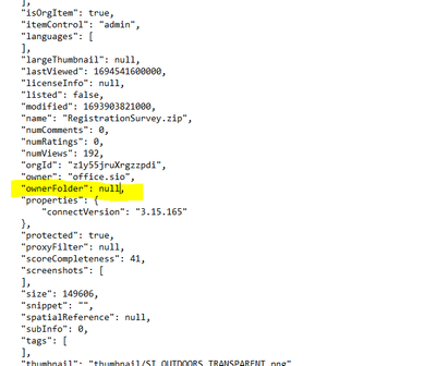

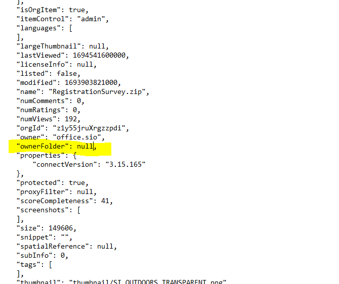

I saw a post on her from a few years ago suggesting I need to update the ITEMINFO File with a new ownerfolder location, but this reverts back to 'null' whenever I attempt to publish.

I had this issue just a couple of days ago and looked for the ID of the folder in which the Survey123 Form's Service is kept in AGOL. When you find this change the ID in the ItemInfo file and then, publish.
It is important just in case that you backup the files stored in the Feature Service before doing the process.

First Connect must be closed for this to work so close Connect.
Second create a folder with the exact same name as the old folder but in your user account.  Look at the top of the AGOL page to get the ID of the folder itself after you create it. (everything in AGOL has a ID just look in the URL)
Then in the INFO file you need to edit these fields to add your username and the folder id above.  Save and close.
"owner": "change to your username",
"ownerFolder": "49e0cf24c",
Then reopen Connect and it should find it.
