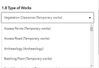

I am trying to put an expression in the xlsform readonly field, so the fields are only editable when certain expression is met (image 1). The expression should apply to records already collected in Survey 123 not to the new entries. In general, when the polygon is selected in the dashboard some fields should not be editable when the record has specific request status.
Although, I can publish the survey without an error, once it's opened in the dashboard as embedded content the field is still editable (image 2).
