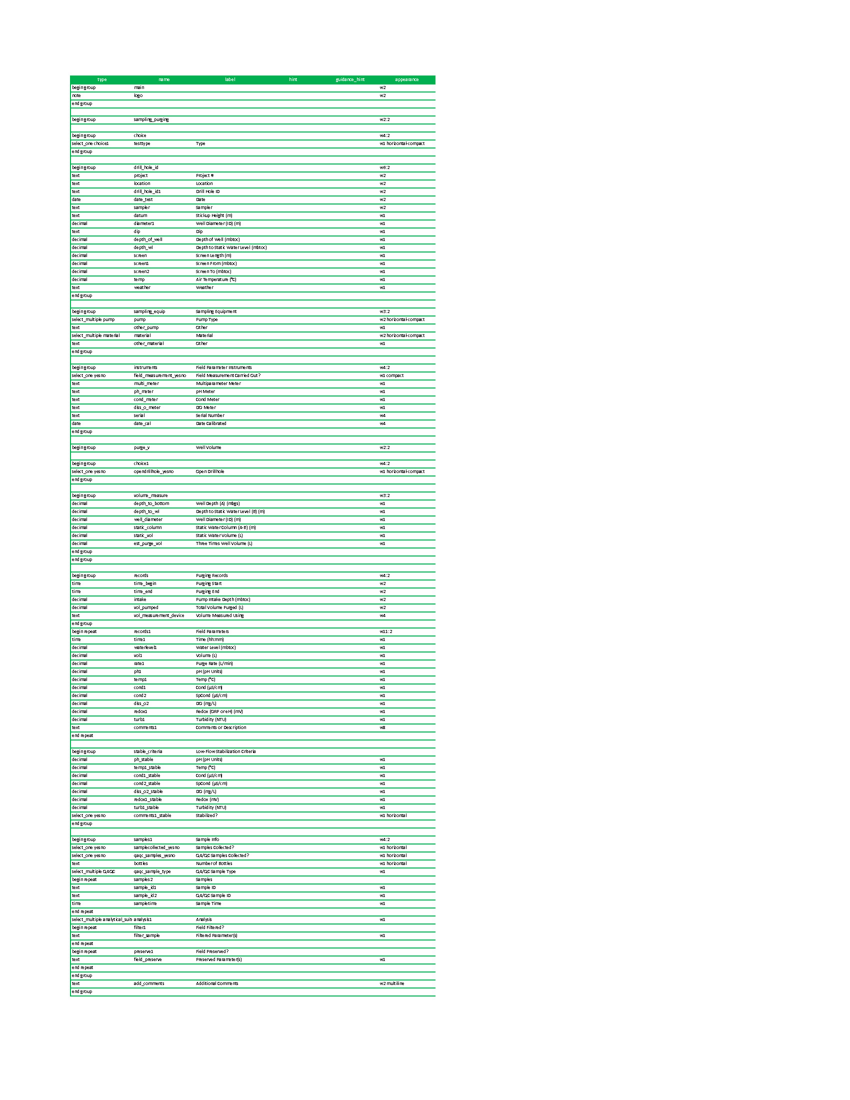

I am experiencing a parsing error while loading a report template for particular lines from my XLS form. Everything else loads fine, including previous and subsequent repeats, and other items within the group. I have tried everything and I keep running into the same parsing error. Seems trivial, but I may be overlooking something.
Error: An error occurred when checking the report template. Failed to parse ${samplecollected_yesno | checked:"yes"} since samplecollected_yesno cannot be found in the current parsing scope.

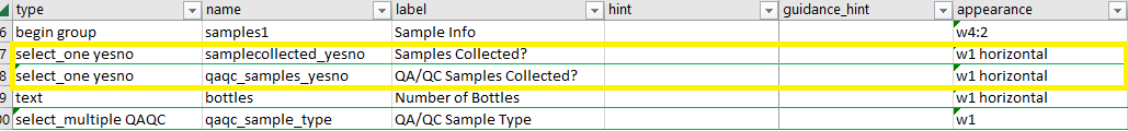

Lines returning an error in XLS form outlined:
XLS form and report template:
ReportTemplate_S123_GWForm_ReportTemplate_20231222.jpgXLSForm_Purging_Sampling_20231018.jpg

Start with ${#samples2}. It looks to be a repeat. You can’t have a repeat in the middle of a row like that. Needs to be first. EDIT: and in case it wasn’t implied, the repeat also needs to be the last thing in a row.
once you start reformatting that row, you will either fix your problem, or create a new one (not a bad thing - just means start there and see where you end up).

Thanks for the response. I ended up reformatting those lines as groups instead of repeats and that seemed to do the trick. In hindsight, I should have considered the effect of nested repeats. Good catch.
